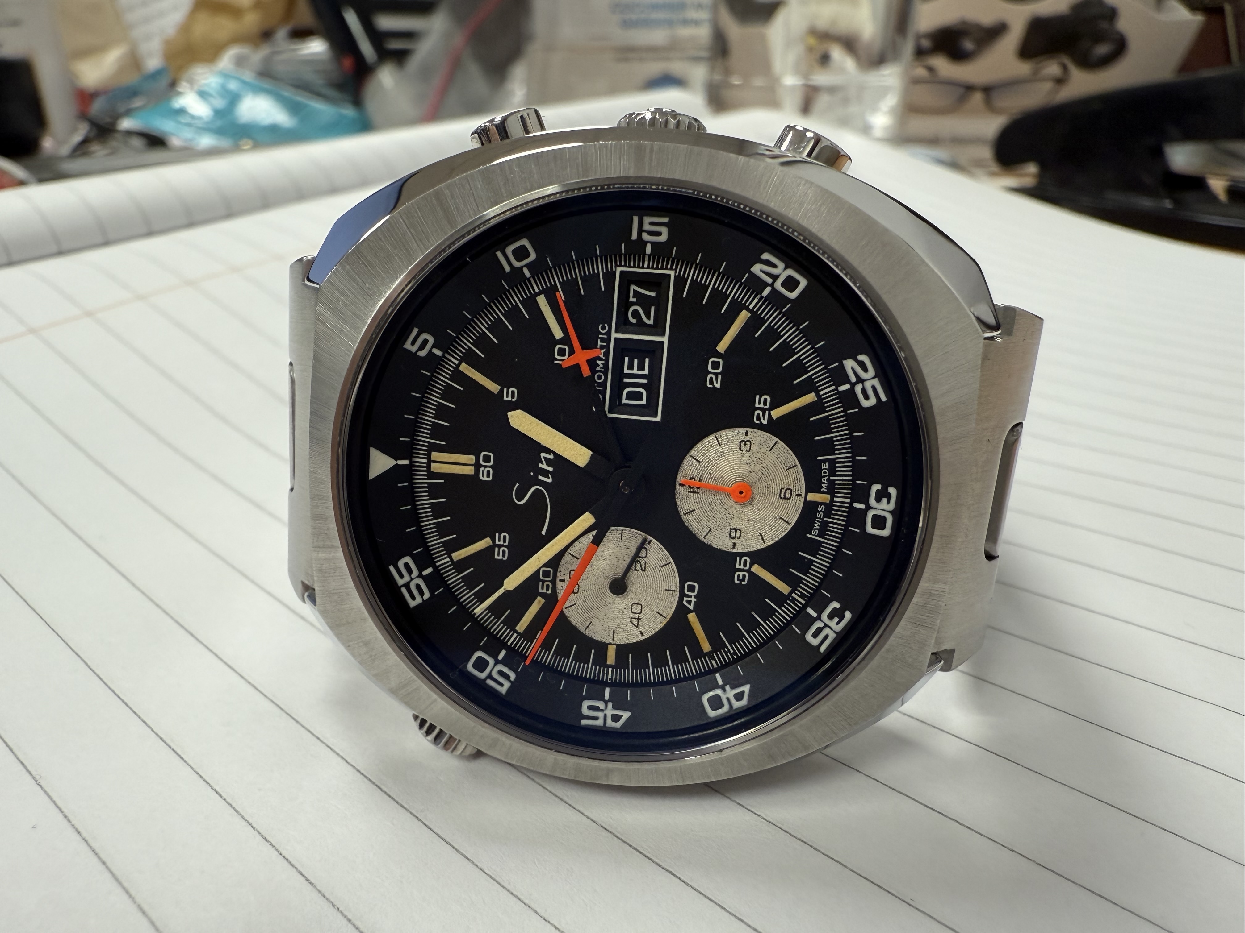

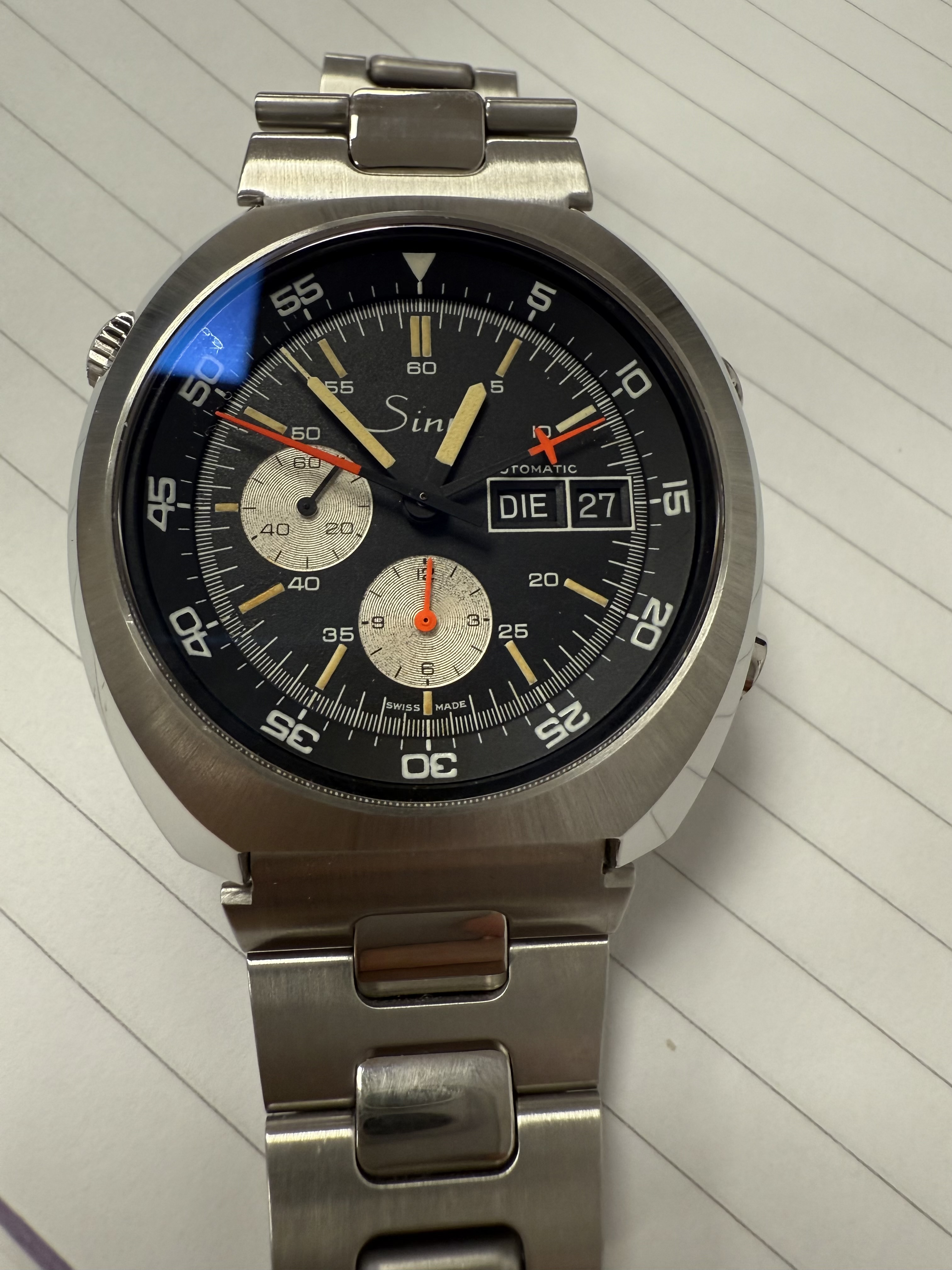

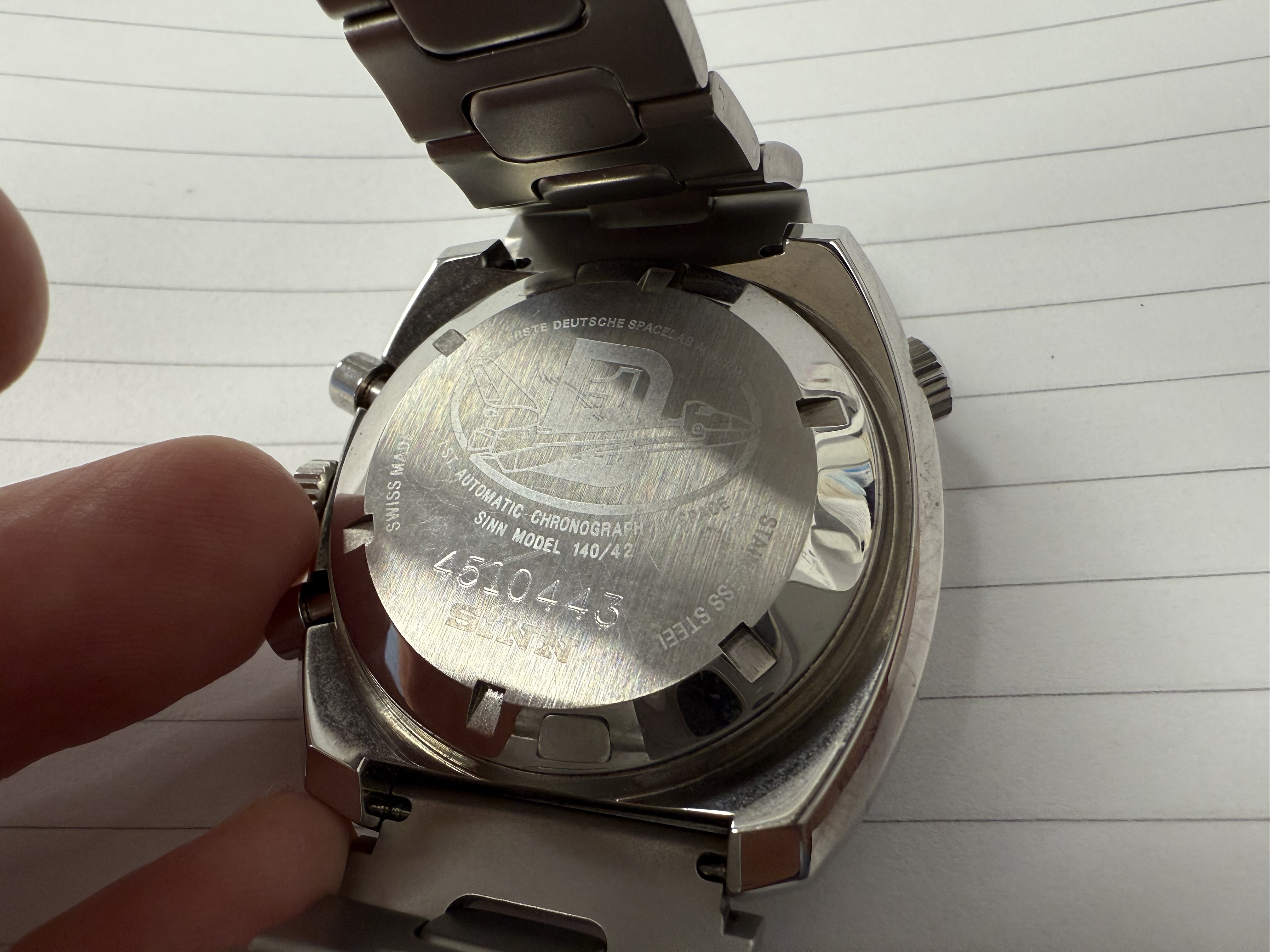

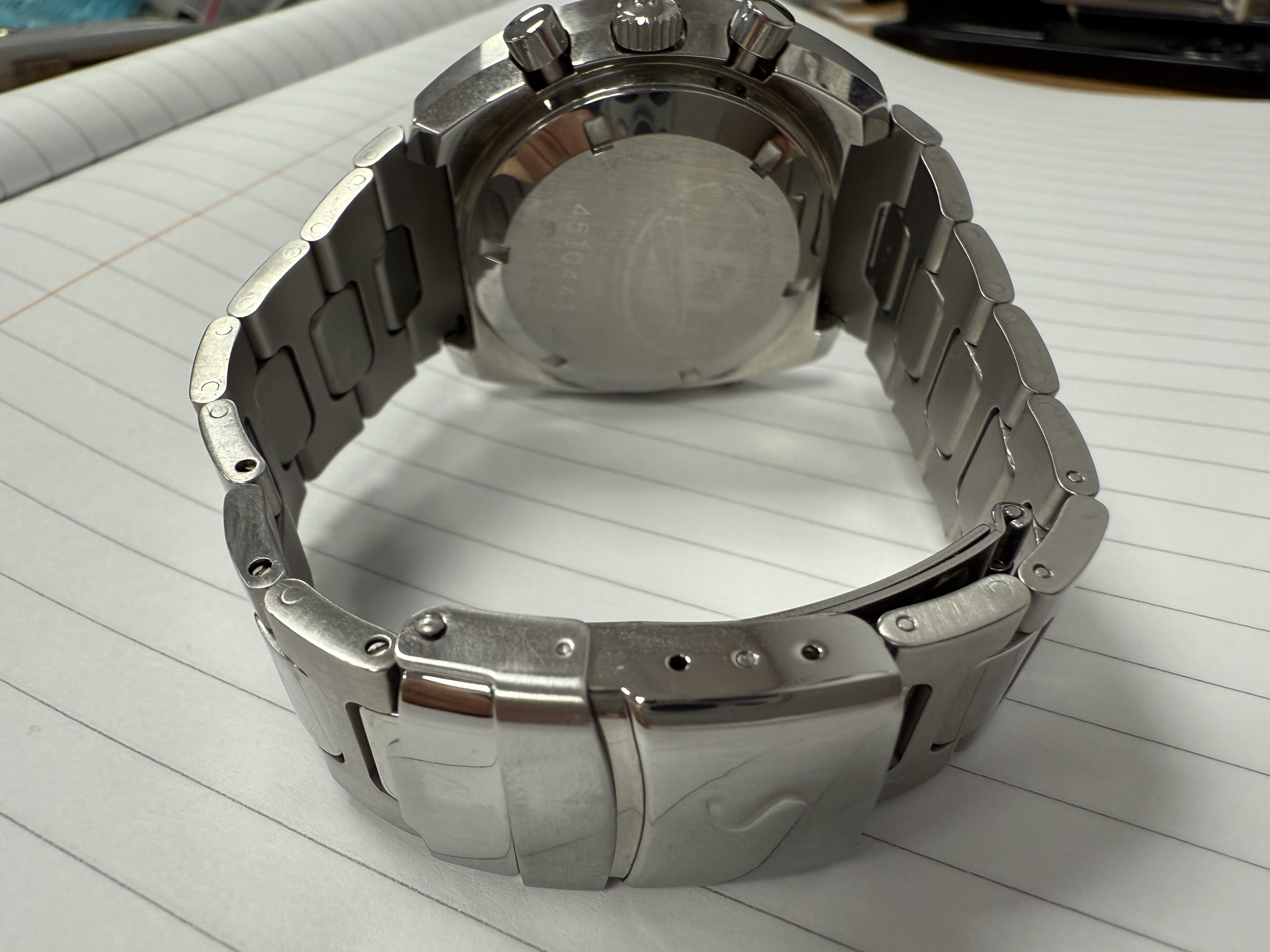

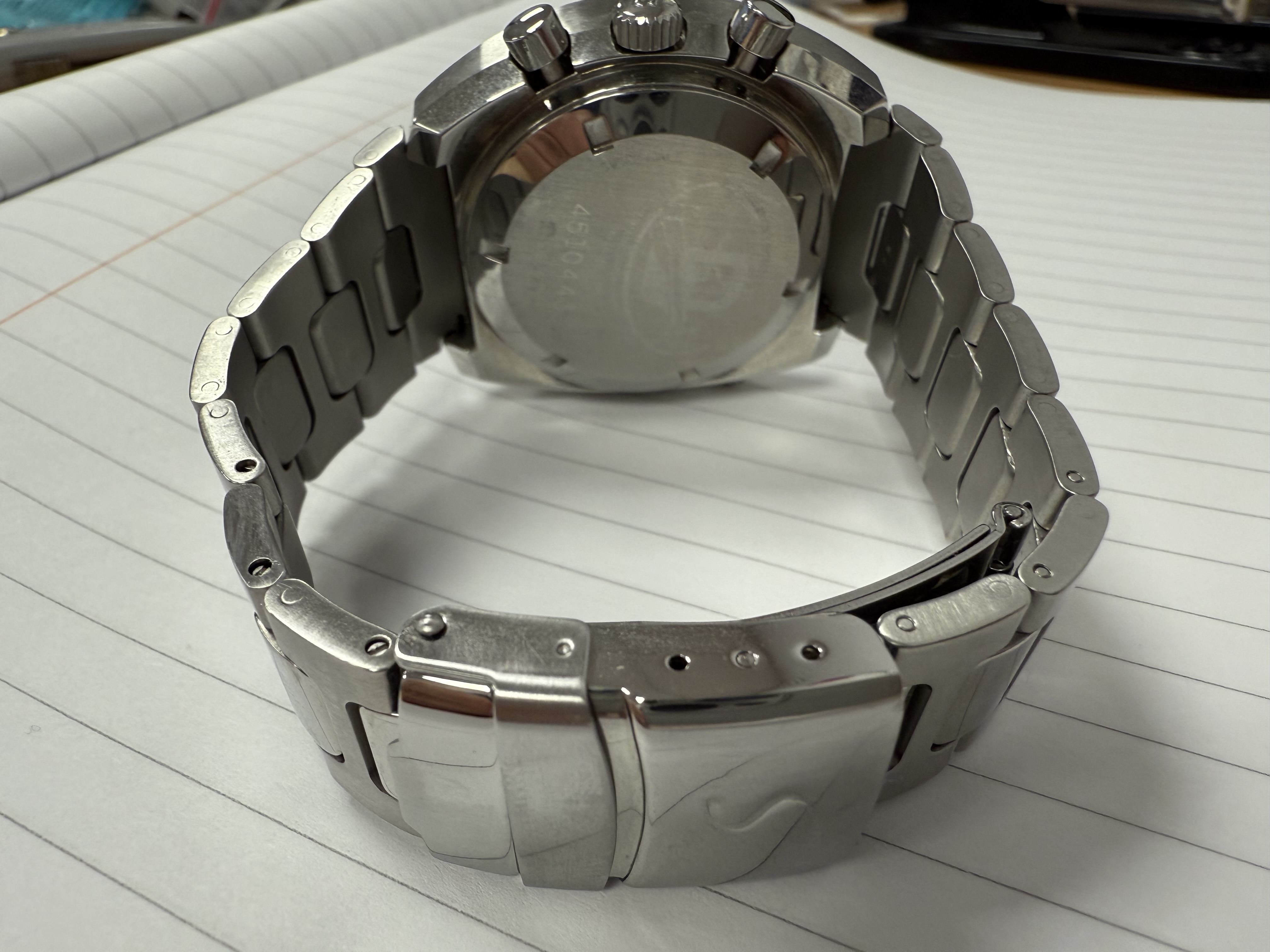

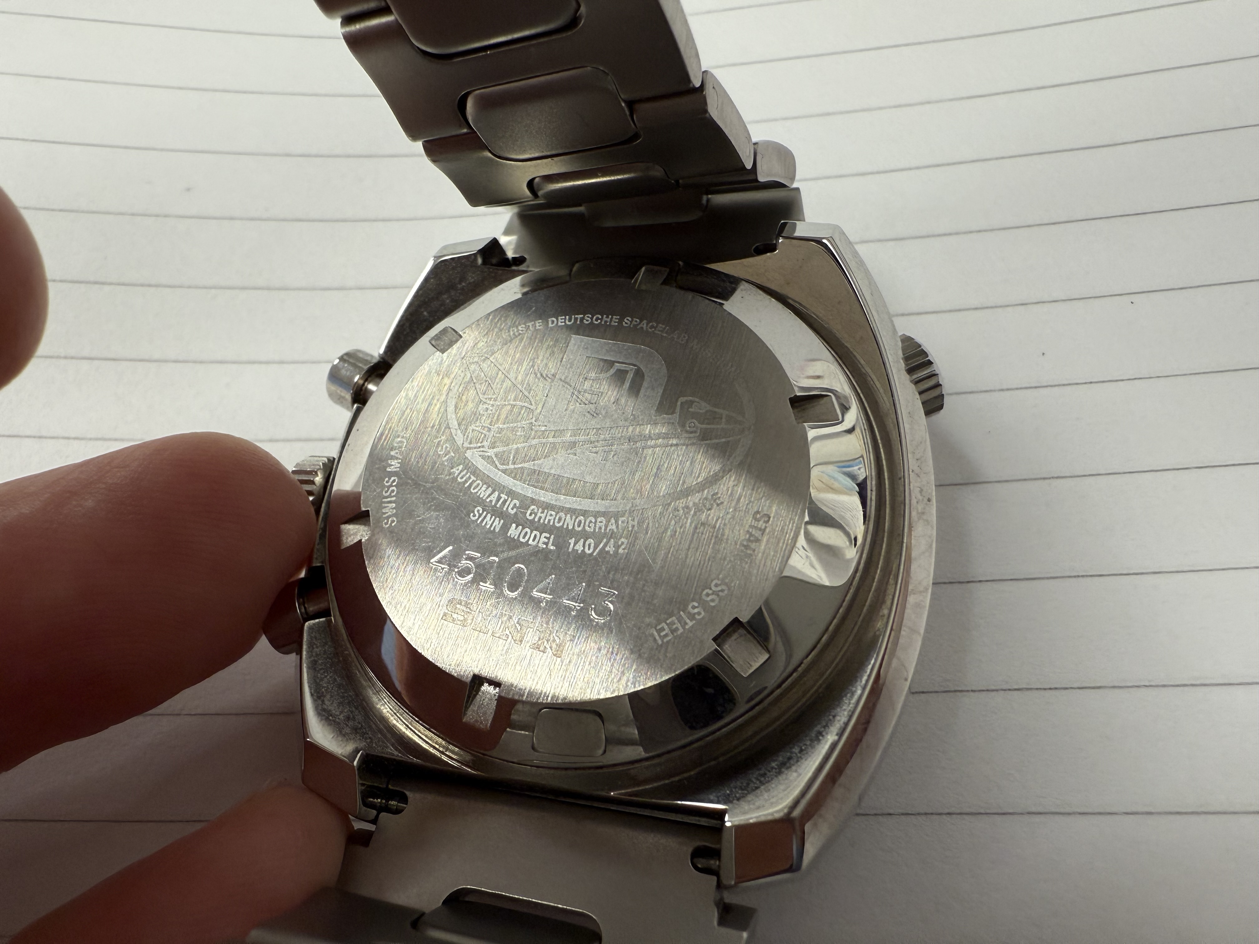

  • Firstly, apologies for bumping this very old thread but I'm trying to clarify whether the watch I have here is a genuine, late 140, dating to around 1987. Originally, I thought I had a 142 with an older dial fitted but, after reading Lemanianers incredibly informative thread, I hope it may be that I have one of the last of the original 140s, a late Gen 3. Here are a few pics, I'd be interested to hear your thoughts.
    Thanks in advance,
    Steve.
  • Hello, and sorry I only noticed your post now.
    Your watch is a Sinn 140 with the "relatively" rare white Totis.
    The dial suggests an early one from the early 1980s to circa 1984. Normally, it should be equipped with a Lemania 5012 movement. However:
    + the inner rotating bezel has minute indices
    and
    + the case back is labeled D1, which, according to the catalogs, was installed from 1987 onwards.
    So I think a Lemania 5100 is working inside.
    The metal bracelet was available from 1994 under Lothar Schmidt.
    But don't worry.
    There are several transitional models from the 5012 to the 5100. The hard facts don't always match up. This doesn't detract from the originality.
    Only the bracelet was added later.
