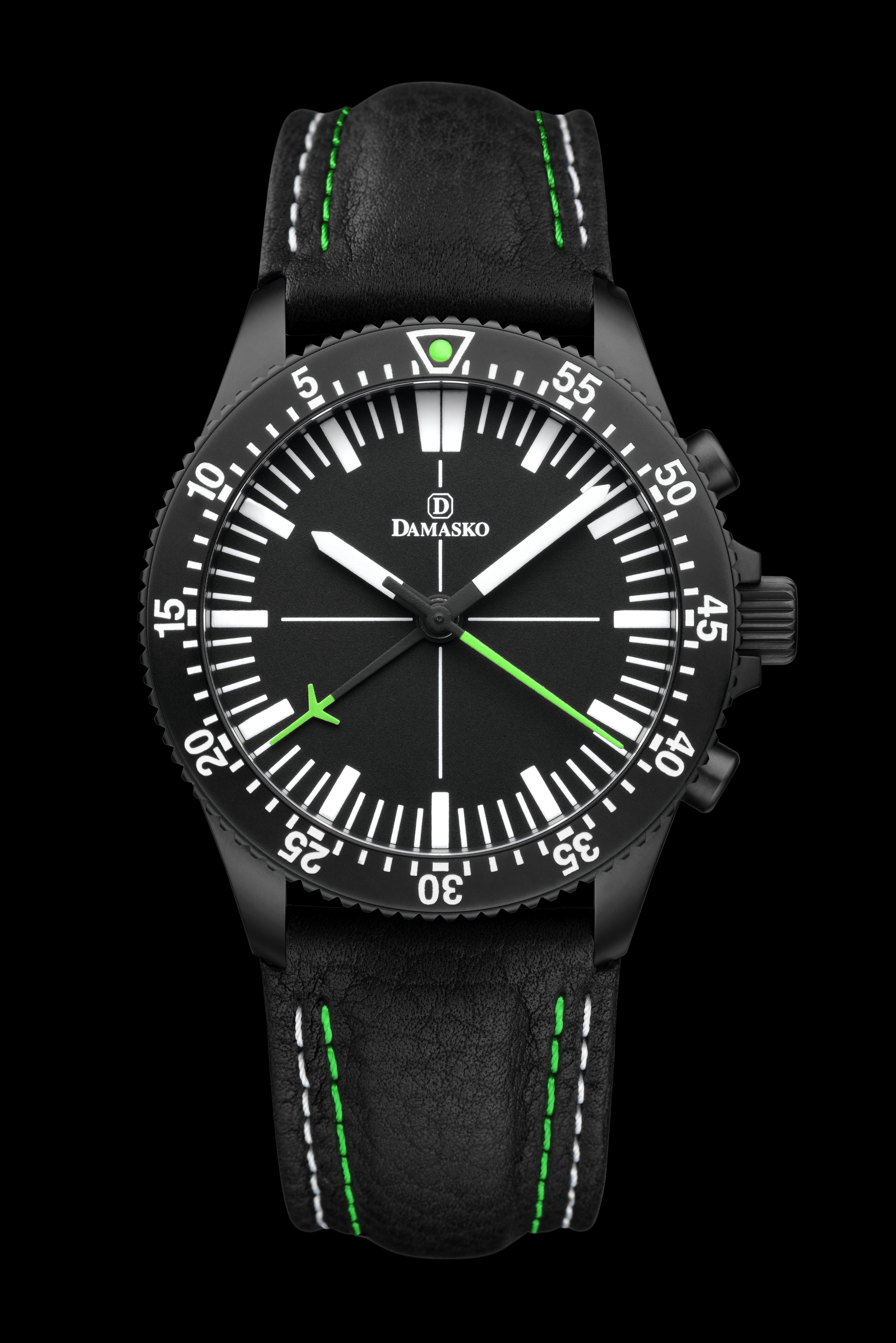

  • Eine seltsame Koinzidenz, gerade habe ich diese Neuankündigung gesehen: Damasko Chronograph DC 80. Falls unerwünscht - bitte löschen.
    Hier die Informationen (Quelle):
    The DC 80 project is based on a patented chronograph construction (modification) named C51, based on the proven ETA/Valjoux 7750.
    Damasko's benchmark for the modification of the ETA/Valjoux 7750 was to significantly increase the readability of the chronograph function. For that reason they put their main focus on the technical realization of a jumping 60-minute stop hand out of the center.
    This new patented construction allows to record stoping times even more easily, faster and more accurately. The Lemania 5100 movement so far set a pattern for a clear and unambiguous readability.
    Damasko's new construction has two advantages in terms of readability:
    First: 60 minutes are now shown in just one complete turn of the center hand rather than the usual 30 minutes, while the assigned minute scale is counted over the full dial.
    Second: Further advantages of this movement modification are the possibilities of adding an independently adjustable second time zone, which can be operated by the crown at 3 o’clock. In addition to that the new movement allows a larger date display directly under the dial. The date wheel is closer to the dial though, as opposed to some module calibers.
    The DC80 model signifies a new chronograph line with the most diverse increments of Damasko's new caliber C51.
    All parts required for the new C51 caliber, such as plates, wheels, pinions, etc. are produced in their factory in Barbing.
    Technical specifications:
    Movement:
    Mechanical Damasko chronograph movement C51-1
    27 jewels
    28.800 a/h
    Hacking (seconds stop)
    Case:
    Stainless steel case, bead-blasted, entirely hardened, Damest coating, screwed case, screw-in crown, water resistant 10 atm, secure fit even in case of a sudden negative pressure, magnetic field protection
    Diameter 42mm / 43,30mm including bezel, height 13,90mm
    Functions:
    Hours, minutes
    Chronograph with center 60-min- and 60-sec stop hands
    Bi-directional rotating bezel with exact minute engagement working with patented ceramic bearing and luminous compound on main markers
    Case and movement are tested according to MIL-STD-810 / Airbus test procedures
    Price: €2780 (leather strap and Damest coating)

  • Warum nicht, danke fürs zeigen!
    Ich dachte Damasko hat das Projekt Chrono a la 5100 inzwischen aufgegeben?
    Scheinbar doch nicht.
    Sehr nah am EZM 1, Zufall?
    Die Farbkombi mit grün wäre nicht so meins, aber das ließe sich ja ändern.
    Schwarz finde ich cool das Gehäuse ist ja quasi das 757er Design. Die Details muss ich nochmal genauer studieren.
    Wie hoch war der Preis?
    € 2.780 ich finde das geht im Vergleich zum EZM 1.1

  • Danke f.d. Info, da werden sich einige Damasko-Fans hier freuen, ich ging auch davon aus, dass das Projekt gestorben ist.
    Ich bin gespannt, wie zufrieden die Käufer sein werden, auch bei Sinn gab es gerade bei den ersten EZM10 damals schon Nachbesserungsbedarf.
    Mir gefällt sie gut, was aber vermutlich an der optischen Nähe zu Sinn liegt. :D :D :D
    Die grünen Farbakzente scheinen sich so langsam als Erkennungszeichen für Damasko zu festigen, das sah man jetzt schon öfter, den Fliegerzeiger allerdings hat ja nicht Sinn erfunden, der kam mMn mit dem Lemania-Werk.
    Respektabel ist die Höhe von 13,9.
    Den Preis wollte ich mal nicht kommentieren, weil das führt ja zu nix.

  • Danke für die Anregung. Die Uhr sieht sehr gut aus (für mich jedoch nicht in der Farb-Kombi schwarz-grün).
    Allerdings bleibt die EZM 1 / 1.1 unerreicht.

  • Mir gefällt sie, danke für's Zeigen! Top1
    Gerade die grünen Elemente wirken für mich frisch und sportlich!
    Wenn das der Start einer neuen Chronographenlinie in diesem Stile bei Damasko ist, kann man sich auf die Zukunft freuen.
